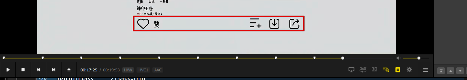

Its kinda hard to explain but the files play normally but theres a weird gap at end of file that is like a dead zone. heres a picture of it.
anyone know what causes this or a way to fix it. Ive tried everything cutting the file, remuxing it with every option imaginable, reripping the file, even cutting file in half then rejoining it. In the picture the large area at end of file is the dead zone you cant click it and the file ends in about the middle of this dead zone. Ive always thot it strange that the files work normally but appear corrupted. neveerr found a fix. Ive seen it MANY times. never figured it out.

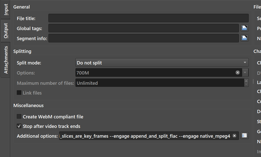

Found something that seems to work. Ive just been trying every button there is and this one removed the strange gap.
STOP AFTER VIDEO TRACK ENDS. buttton should be turnned on.

My best guess is that there’s a subtitle entry with a bogus start time located quite a while after the other content (audio & video) ends. Any content counts towards the file’s total length, even if it’s only content of a single track.
The option “stop after video track ends” was made for situations such as this one: it cuts of the output file right after the last video packet ends, discarding the packets of all other tracks whose start time is higher than the last video track’s packet’s end time.
As this is a destructive operation it isn’t enabled by default.
