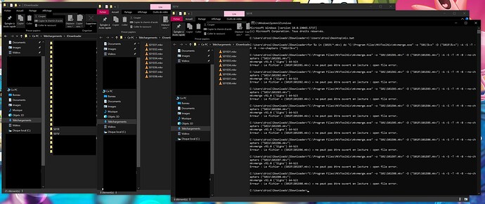

So what’s the full actual error message? 'cause you only posted part of it. Maybe that’ll shed some light on what’s different now on your end.
Additionally it would help to see the directory listings of both directories (the original ones, meaning screenshots, not you typing out the names, otherwise chances are you actually mistype something).
Sure! Here is a screenshot
The error is in french but it’s: “Error: : The file “(S01R\S01E03.mkv)” could not be opened for reading: open file error”
EDIT: Never mind… I just realised by translating the error in english that I removed the spaces in the script and it was because of that… Since I didn’t use it for a long time, I thought it was a mistake I made.
I realized it was trying to find a file called (S01\S01E01.mkv) with the parenthesis in the name.
