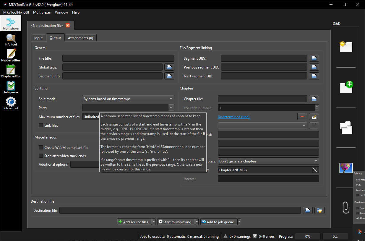

I think I’m late to this but you can use the “splitting” feature in the gui under the “output” tab. You can use the “By part based on timestamps” option.
The guides written in tooltips visible when you place your mouse over the field can help you get the correct format.
Please note you cannot make precise cuts, mkvtoolnix will cut wherever it can after the given timestamp if it can’t cut exactly there.
Hence you can definitely put 02:00:26-02:04:55 into the “Parts:” field.
If your format was incorrect you’ll see “error” when you click on “start multiplexing” and a red cross will blink. You can get rid of the flashing red symbol by right-clicking it and selecting “Acknowledge all errors/warnings”
