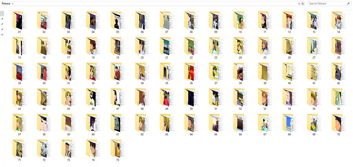

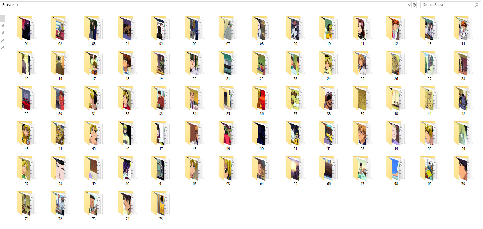

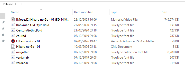

It’s 75 folders that each contain an mkv, the corresponding .ass subtitle file, fonts and an xml chapter file. A look into one folder:
I want to mux all these files together into 75 different mkv files into a singular folder. I know I could do it manually but thought batch would limit any mistakes.
