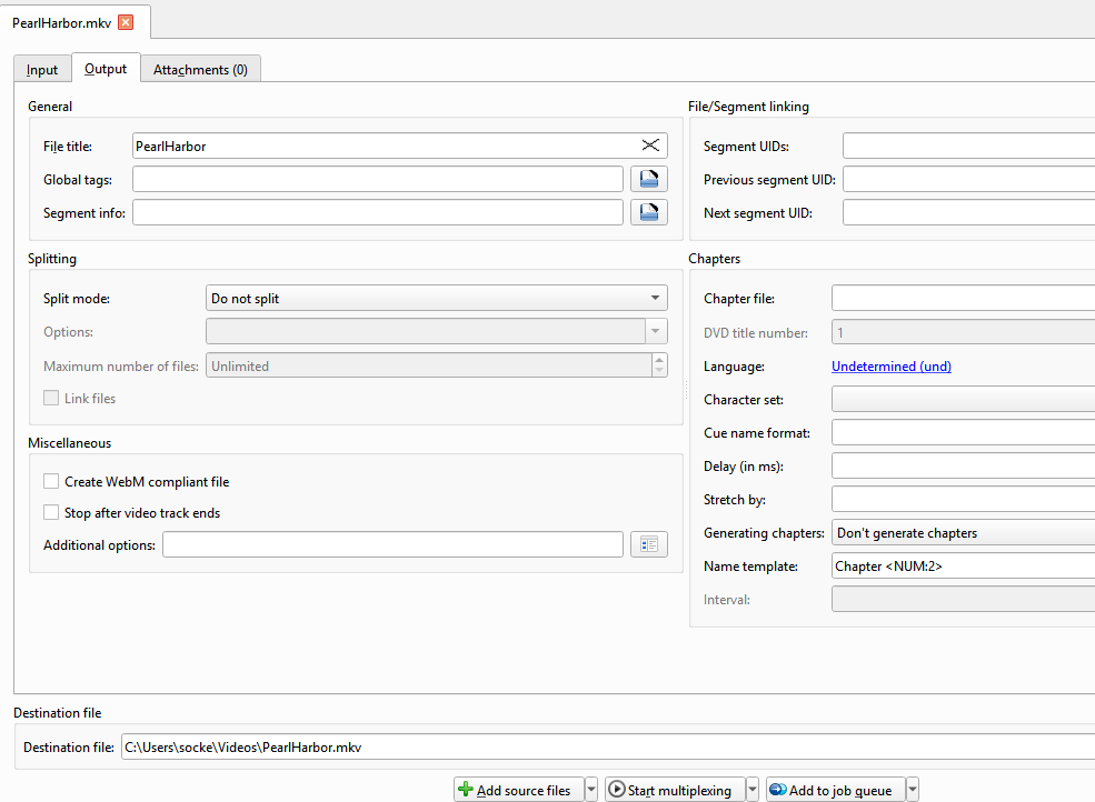

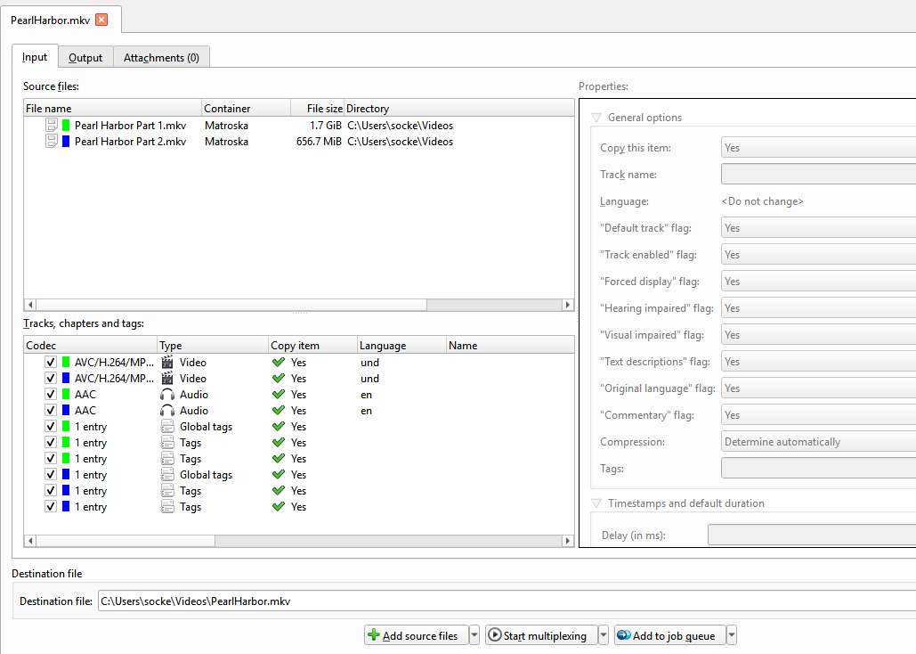

That’s where I started. I added the two files to the Input tab Source file, and the Output file name to the Output tab Destination file name. For S & G, I also added the new file name to the Output tab, General File title. I didn’t specify any options.
All I get is the first file. :worried:
That article pretty clearly states that you have to use “append” and not “add”, which can be found in
  • the context menu when you right-click on an existing file
  • the menu appearing when you click on the small arrow on the right end of the “add source files” button
Thank you! I missed the part about clicking the first file and appending to it. I kept adding both files to the input individually! What a rookie error…
